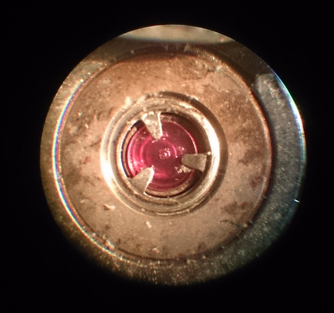

Сообщение от uruk hi Посмотреть сообщение
Неужто придется отгибать "усики"?
Вложение 3710406
Вот тут опытом делятся. Ф ошибки исправлять не стал - как есть: "Pretty sure this is a swiss ruby neutro shock, your picture is not clear enough but there aren't many like this stupid design. Vibrax is another but the catalogue shows a steel cap. Ive stripped a similar one down which i think is from a citizen, japan also used some neutro shock types. Clipping off the stud holder releases the regulator arm then you can get in with a sharp blade to prise the setting out of the cock. This is about as far as you can go with disassembly unless you want to risk bending up the spring prongs . Getting them pressed back down tight over the cap will be near impossible. I thought the setting had a seam at the bottom end that might press apart, so i gave it a go . It came apart but nevet to be reassembled, split in half and from inside there is no seam so everything goes in from the front. Personally i would break it down to the setting and flush it out best you can then push oil in from the underside with a whisker. Of course yours may not be identical, so post more pictures as you strip it down. "
Есть фото обратной стороны баланса?

Сообщение от PoljotNormalnij Посмотреть сообщение
Наверное, так и поступлю, тем более, что такое мнение уже прозвучало. А там - куда кривая выведет.
