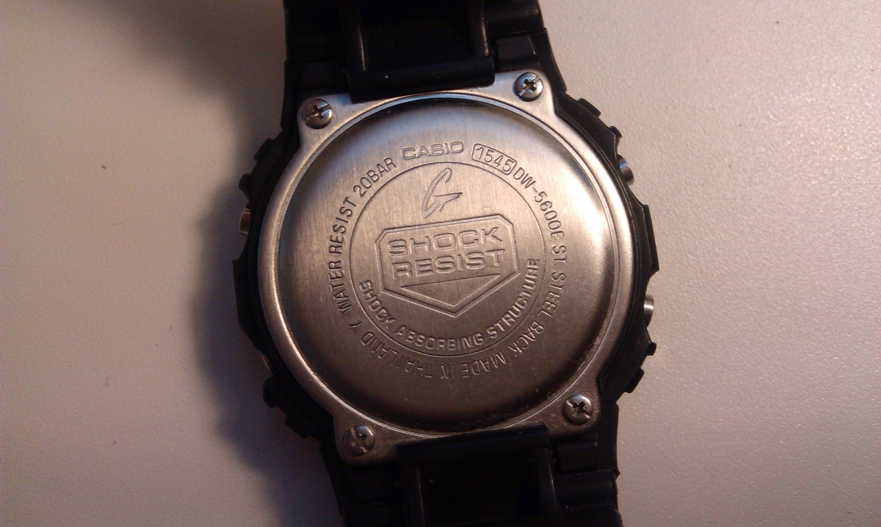

На каких Шоках завинчивающаяся крышка?
* AW-500, also AW-594 (World Cup '94)
* DW-5000 (re-editions, DW-5025, etc...)
* DW-5000C
* DW-5200
* DW-5400
* DW-5500
* DW-5600C, also DW-1983 (10th annv.) & SWC-05 (World Cup '94)
* DW-5700 (re-editions)
* DW-5700C
* DW-5800
* DW-6300 Frogman
* DW-82xx Frogman
* DW-8900 (SS, similar to MRG-100)
* DW-8950 (Ti, similar to MRG-1)
* DW-92xx
* DW-99xx Frogman/Seaman
* DW-9600
* G-2000
* G-2700
* GL-110
* GS-100
* GS-300
* GS-310
* GS-5x0
* GS-1000
* GW-20x solar Frogman
* MRG-1
* MRG-100
* MRG-110
* MRG-12x
* MRG-131
* MRG-200
* MRG-210
* MRG-220
* MRG-100x Tactician
* MRG-1100 MR-G Frogman
* WW-5100
* WW-5300
