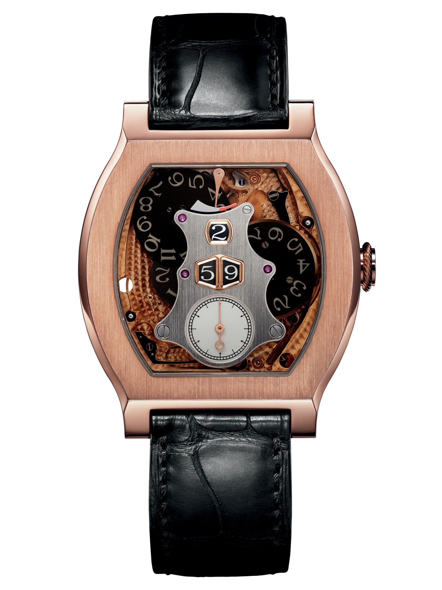

SIHH-2017 The F.P. Journe Vagabondage III
The F.P. Journe Vagabondage III, The World's First Mechanical Digital Jumping Seconds Wristwatch
The F.P. Journe Vagabondage III is the third in Journe's series of tortue-case shaped jumping time Vagabondage watches, and it's the most exposed, with much of the mechanism for advancing the time disks open to view. Not only that, it's the very first wristwatch with a jumping digital seconds indication, which I would have bet real money was impossible, thanks to the energy needed to jump the disks. It's also going to be the very last Vagabondage watch, according to Journe.

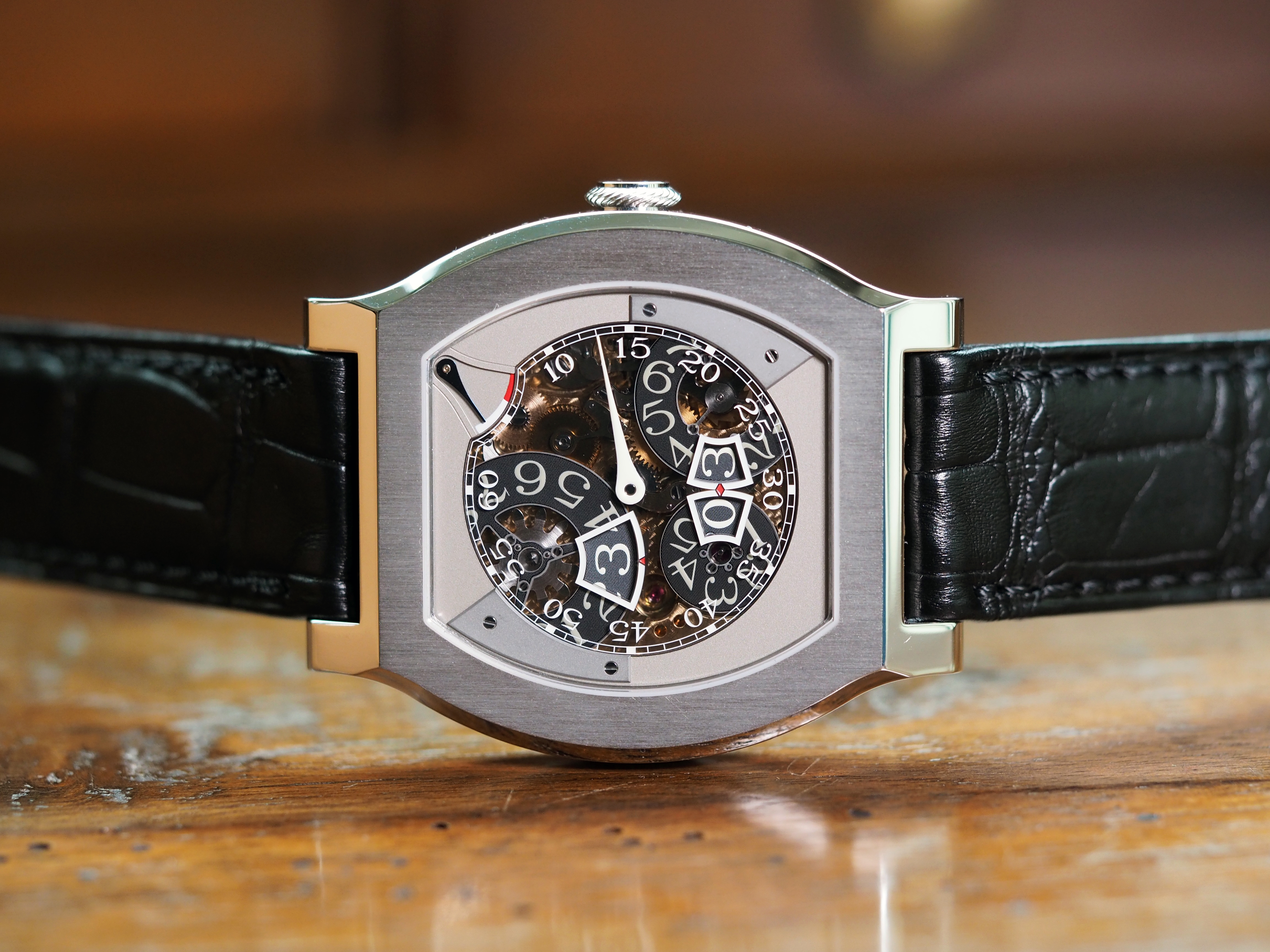

The very first Vagabondage watch was a jumping hour watch with an unusual display: the numerals for the hours are represented by a disk on the dial, and the window surrounding the current hour carries the hour numeral around the dial once per hour, acting as the minute hand. Vagabondage I started as a limited edition for the auction house Antiquorum, and was subsequently released as a limited series in platinum and diamond-set platinum.
Vagabondage II was a different take on the digital display of the time. Instead of the wandering hours complication used in Vagabondage I, Vagabondage II uses a digital jumping hours and minutes display. Due to the varying energy requirements Journe installed a remontoire d'égalité (a constant force mechanism intended to isolate the energy going to the balance from the power variations in the going train caused by jumping the disks).

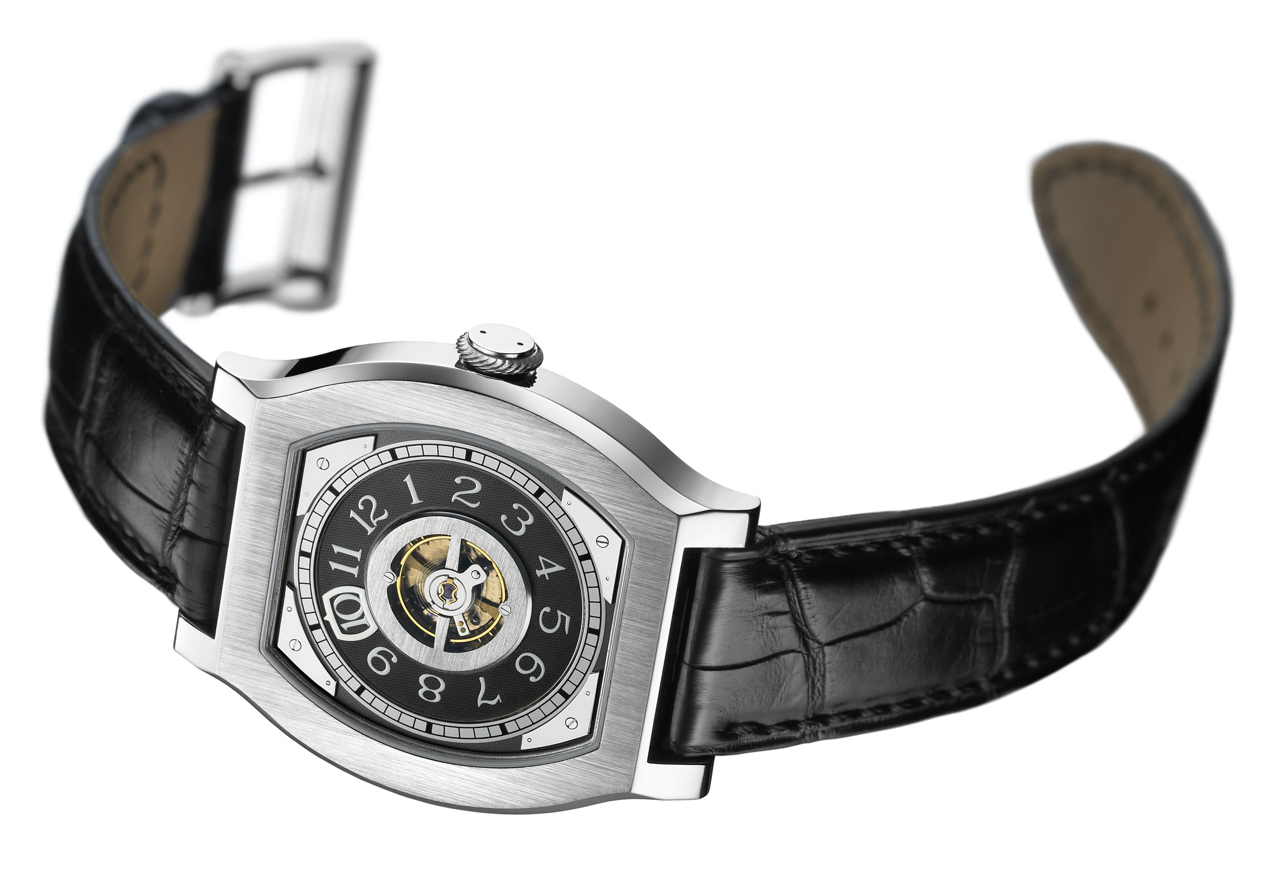

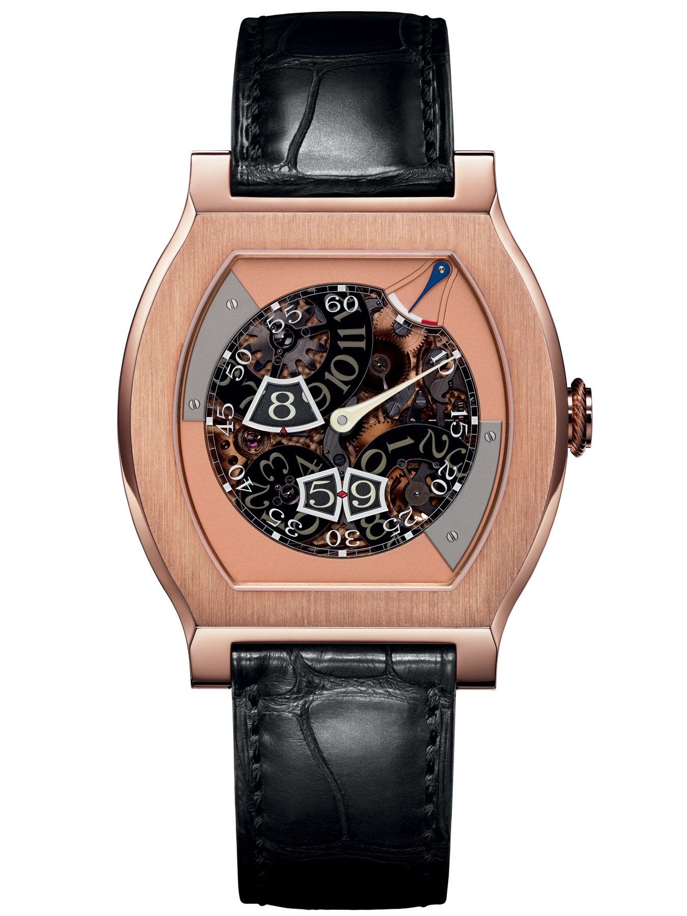

Vagabondage 1 серии
Vagabondage 2 серии
Vagabondage III is not only the most exposed mechanically, but probably also the most difficult of the three to get working, as jumping the seconds produces a significantly increased energy load. Once again, Journe's using a one minute remontoire d'égalité, and it's certainly the most visually dynamic jumping digital display wristwatch we've ever seen.
The Vagabondage III is a fairly large wristwatch, outsizing most of Journe's other timepieces – however, the nature of the complication dictates a more substantial movement and therefore, a larger case. Vagabondage III's movement, caliber 1514, is 29.3 x 28.2 x 5.58mm and the case overall, 45.2 x 37.6 x 7.84mm. (For comparison, the jumping digital hours and minutes Lange Zeitwerk, which also has a remontoire, is 41.9 x 12.6mm.)
I think the size is more than a reasonable tradeoff, however, for a world-first in watchmaking (these come along a lot less seldom than you'd think). It's also the most aesthetically successful of the Vagabondage watches, to me – this is a matter of personal taste of course, but i think the white outlines around the display windows, and the use of a smoked sapphire dial, delivers the message of complexity without adding unnecessary clutter. According to F.P. Journe, owners of Vagabondage I and II will have preference for ordering (which is reasonable given their prior financial, and probably emotional, investment in the Vagabondage series) and there will be 69 pieces in platinum, and 68 in red gold. Serious Journe collectors, and those for whom horological firsts are irresistible, take note.
The Vagabondage III: movement, hand-wound rose gold caliber 1514, 29.3 x 28.2 x 5.88 mm, with digital jumping hours and seconds and remontoire d'égalité. Case, platinum or red gold, 45.2 mm x 37.6 mm x 7.84 mm. Price not yet announced

Вот и пресс-релиз на русском (ну, или относительном русском)))
Vagabondage III
Мировая премьера: Цифровые Скачущие Секунды
Третий выпуск Трилогии Vagabondage
F.P.Journe представляет третью и последнюю часть серии Vagabondage (Странствия), часы « Vagabondage III », произведенные лимитированной серией из 69 экземпляров из Платины и 68 экземпляров из красного Золота 750 пробы. F.P.Journe – это единственная Мануфактура, изучающая и производящая особый калибр для лимитированной серии, состоящий только из 137 экземпляров.
Необходимо вспомнить факты создания часов Vagabondage, которые по определению являются анти маркетинговым продуктом. В 2004 году по случаю 30-летнего юбилея дома Antiquorum, Франсуа-Поль Журн делает наброски 3 новых часов в корпусе формы Плоская Черепаха (запатентованная модель), с цифровой индикацией времени и циферблатом без подписи.
Эти 3 часов из белого, желтого и красного Золота, с механизмом из латуни выставлены на аукцион в пользу исследовательского института болезней головного и спинного мозга ICM, www.icm-institute.org. Интерес, вызванный этими часами, утроил ставки на аукционе по отношению к начальной оценке.
I – Цифровые Часы
После успеха продажи этого лота, Ф.-П.Журн выпускает в 2006 году серию Vagabondage I. Она называется Vagabondage (Странствия), поскольку индикация времени производится при помощи блуждающего цифрового указания времени и является результатом странствий в работе Франсуа-Поля Журна, за пределами обычных коллекций. Эта лимитированная серия формы Плоская Черепаха ® отличается от круглых корпусов, столь дорогих марке. Будет произведено 69 экземпляров из Платины и 10 экземпляров с инкрустацией бриллиантами багет, с механизмом из розового Золота 750 пробы с ручным подзаводом. Коллекция будет продаваться без какой-либо коммуникации и клиенты будут раскупать эти часы с молниеносной скоростью. Так родилась легенда Странствий.
II – Цифровые скачущие Часы и Минуты
Второй выпуск серии Vagabondage был в 2010 году и выпущены в 69 экземплярах из Платины, 68 экземплярах из Красного золота и 10 экземплярах из Платины с инкрустацией бриллиантами багет. В этих часах сохранился механизм с ручным подзаводом и цифровой индикацией, но добавилась секундная стрелка в положении 6 часов и запас хода в положении 12 часов. Циферблат из дымчатого сапфира, без подписи F.P.Journe, позволяет увидеть сердце механизма из розового Золота 750 пробы. F.P.Journe специально разработал барабан, а также ремонтуар постоянной силы, позволяющие лучшее управление энергией для мгновенного перехода скачущих минут и часов.
III – Цифровые скачущие Часы и Секунды
С огромным нетерпением коллекционеры ожидали выхода в свет Vagabondage III. Эта третья серия сохраняет форму Плоская Черепаха®, по размеру равную часам Vagabondage II, механизм с ручным подзаводом все с той же цифровой индикацией, ремонтуаром постоянной силы, позволяющим часовой системе двигаться вперед с каждой секундой.
Внутренний циферблат из дымчатого сапфира, окруженный внешним циферблатом с прикрученными накладками, все так же без подписи F.P.Journe, открывает взгляду механизм из розового Золота 750 пробы. Окошки цифровой индикации часов в положении 10 часов и секунд в положении 6 часов, окружены белой сеткой. Минуты по центру указываются белой стрелкой, а запас хода в положении 1 час стрелкой из вороненой стали.
Три цифровых индикации времени отныне образуют завершенный триптих. Предпочтение отдается владельцам часов Vagabondage I и II для приобретения часов с идентичным номером первых выпусков; таким образом, коллекционеры могут пополнить трилогию и стать обладателями части часовой истории F.P.Journe.
Серия Vagabondage III доступна в Бутиках и Центрах F.P.Journe,а также у авторизованных дилеров.
ТЕХНИЧЕСКИЕ ХАРАКТЕРИСТИКИ – VAGABONDAGE III
Механизм Калибр 1514
Ручной подзавод
Розовое Золото 750 пробы.
Размеры механизма
Общие размеры : 29.3 x 28.2 мм
Посадочные размеры : 29.3 x 28.2 мм
Общая высота: 5.88 мм
Высота штока : 2.96 мм
Диаметр резьбы штока : S0.90 мм
Маятник Хронометрический баланс с 4 инерционными грузиками
Плоская спираль Anachron горячей ковки
Подвижный держатель колодочки
Без градусника
Система крепления спирали лазером Nivatronic
Штифтовая GE колодочка
Частота : 21,600 полуколебаний / x, (3Гц)
Инерция : 10.10 мг x см2
Угол подъема : 52°
Амплитуда : 0ч на плоскости : > 260°
24ч на плоскости : > 260°
Основные характеристики
Ремонтуар постоянной силы одной минуты, патент EP 1528443
Линейный анкерный спусковой механизм, 15 зубьев
Барабан с двойной пружиной
Цифровая индикация часов и секунд
Индикация минут центральной стрелкой
Двухпозиционная заводная головка
Коррекция времени в положении 2 в 2 направлениях
Маленькая секундная стрелка в положении 6 часов
Запас хода 40 часа
Отделка высокого качества
Частичное жемчужное зернение на платине
Узор Côtes de Genève на мостах
Полировка концов штырей, полированные прорези и окружности
Полировка головок винтов
Корпус Форма Плоская Черепаха 45.2 мм x 37.6 мм
Общая высота : 7.84 мм
Циферблат: Дымчатый сапфир
Лимитированная серия
Платина PT 950 69 экземпляров
Красное Золото 750 пробы 68 экземпляров
Лимитированная Ювелирная Серия
10 экземпляров из Платины Lunette с инкрустацией 50 бриллиантами багет VVS1 цвет F-G по 8.34 карат и разворачивающейся застежкой из Платины с инкрустацией 18 бриллиантами багет VVS1 по 0.86 карат. Бриллианты багет идут противоположными парами, за исключением No 9, повторяющегося 4 раза
Количество компонентов
Механизм без циферблата : 249
С корпусом на ремешке : 281
Камни 32

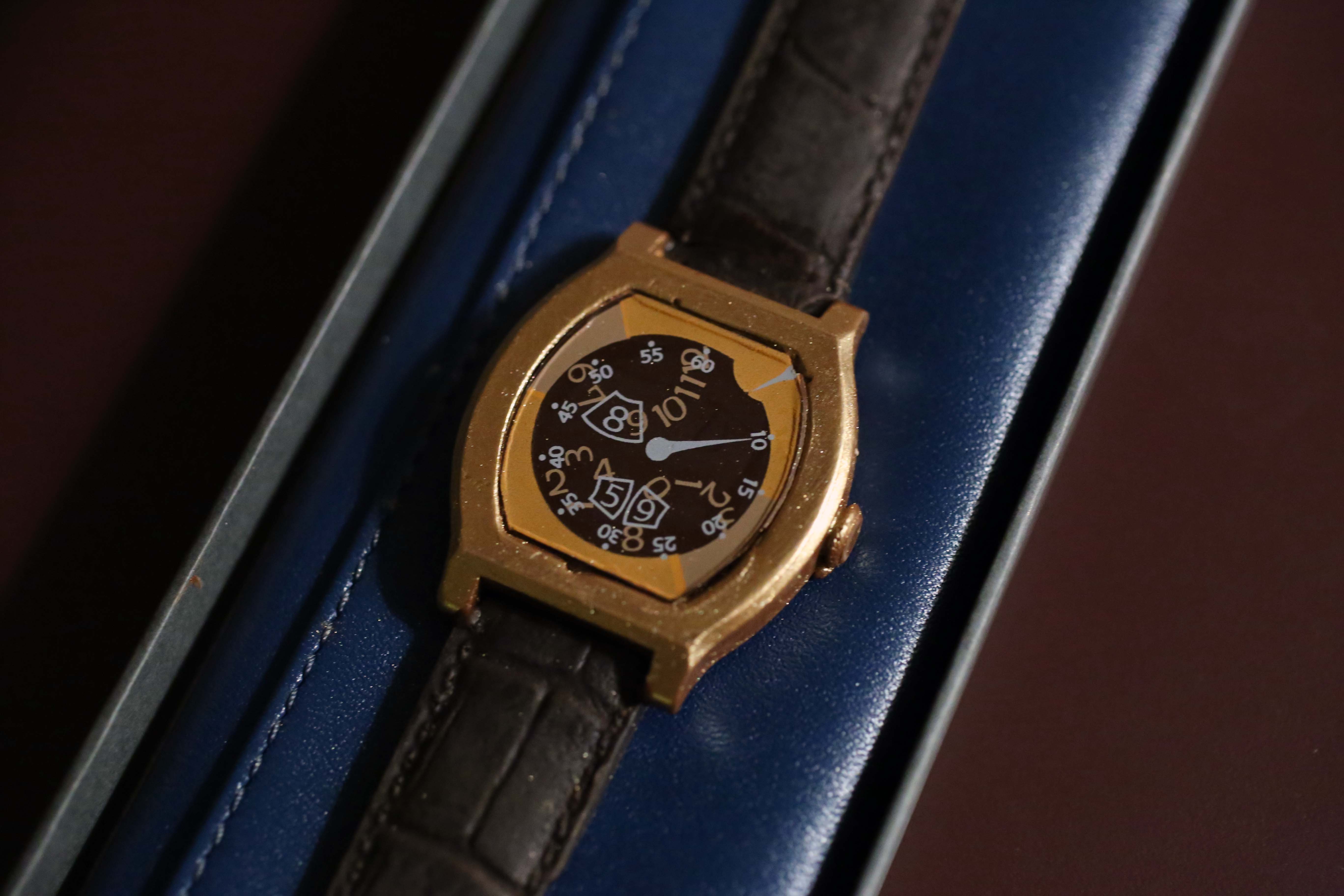

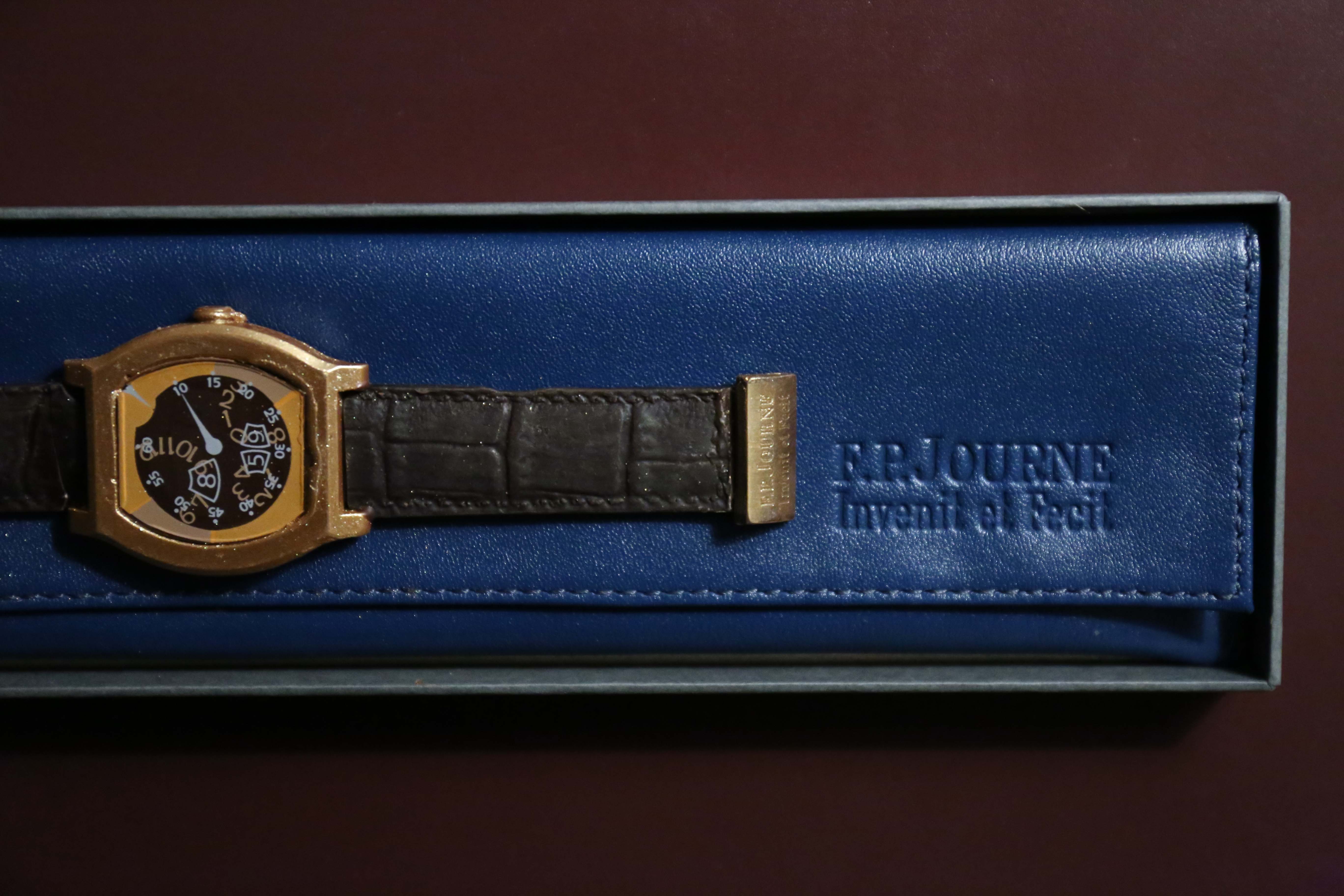

А вот прессе перепали шоколадные варианты этой же модели. Увы, не работающие ))
Правда, такого рода презенты я уже раньше делал ))

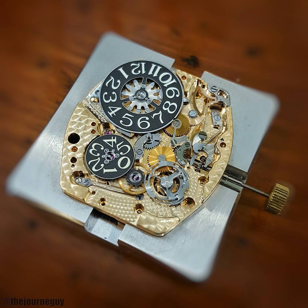

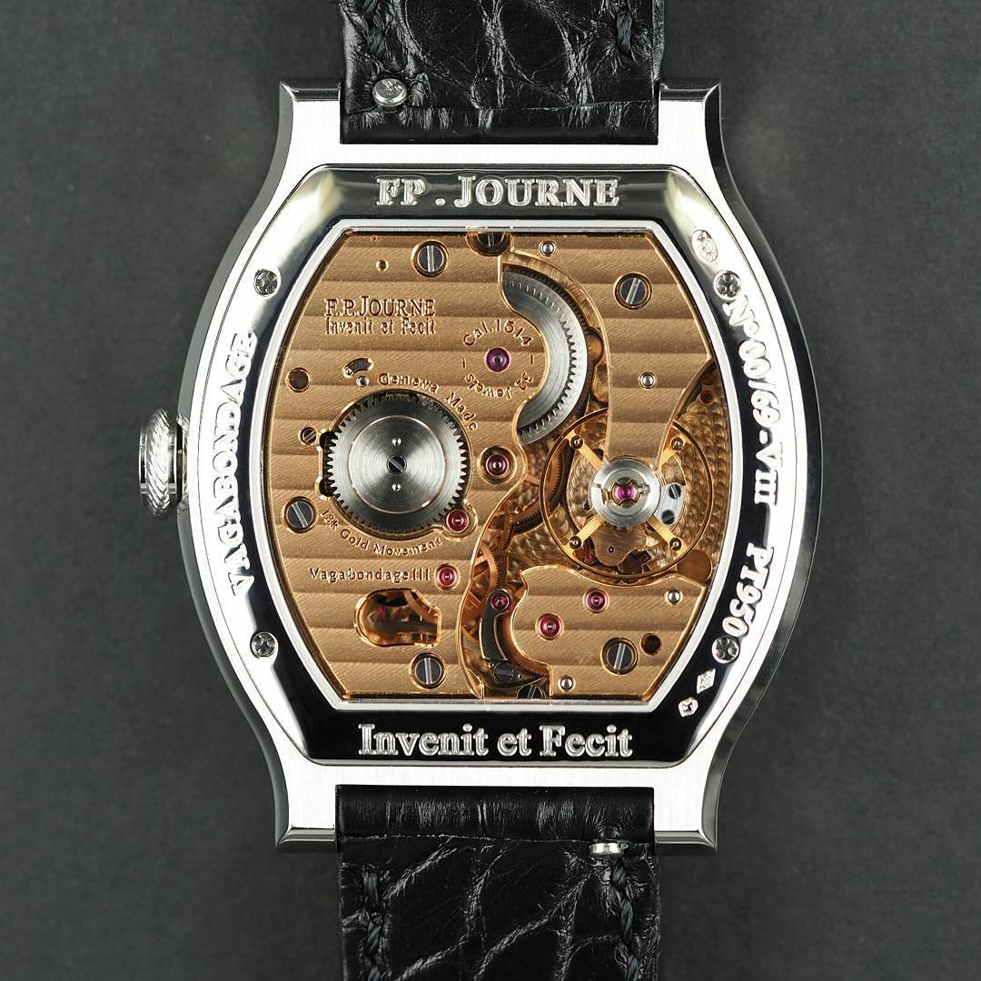

Фото механизма
и вид сзади
