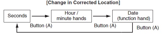

В английском варианте намного детальнее:
Correcting the Reference Position
· The reference position is corrected by repeatedly changing the corrected location in the order of seconds c hour/minute hands c date (function hand turns) each time
button (A) is pressed.

Алгоритм:
