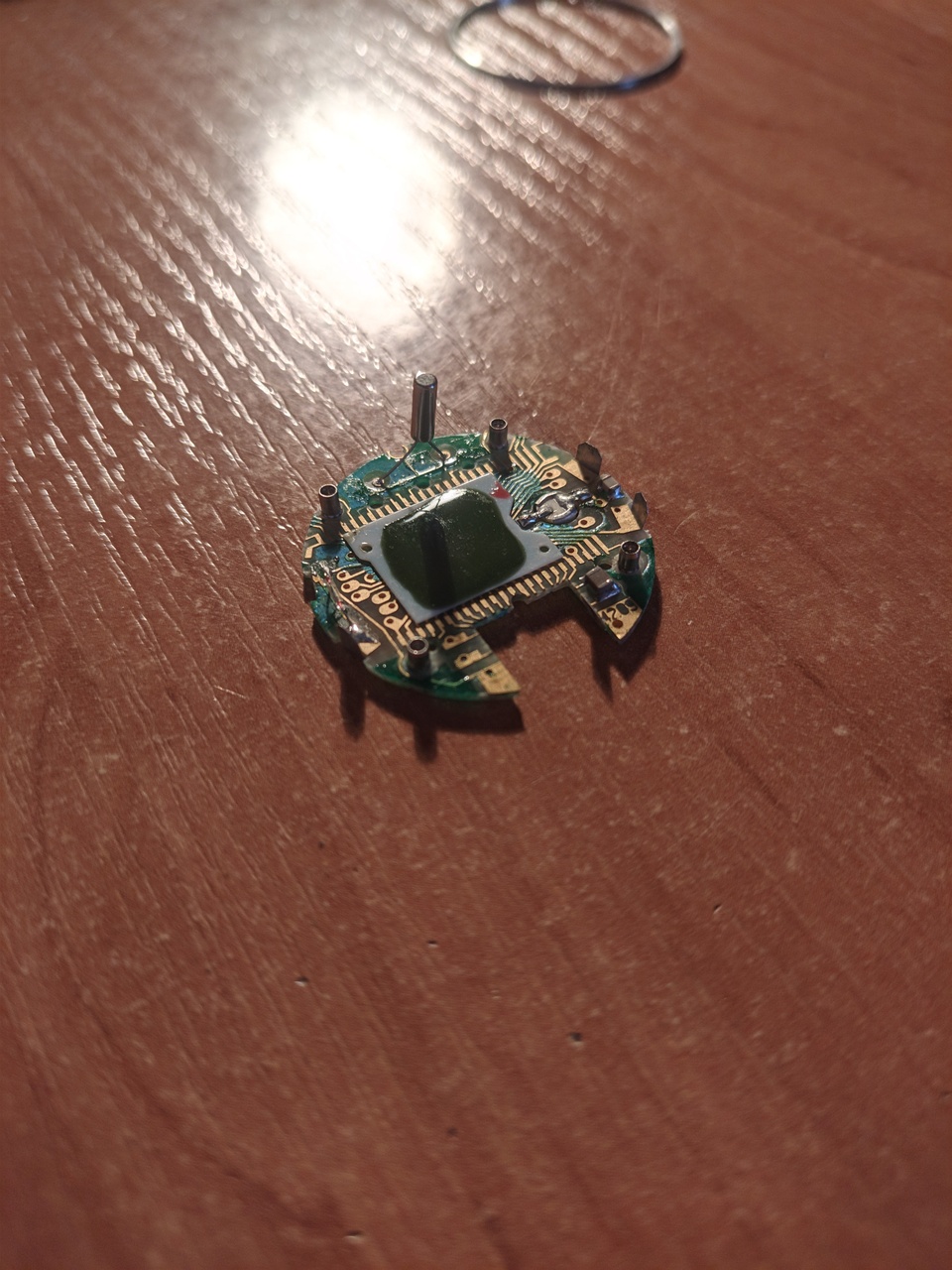

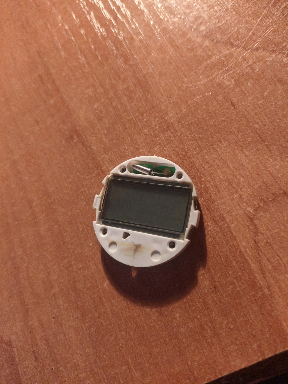

Настало время перепаивать кварц. Точность уходила около 1-2 минуты в неделю.
Кварц 2x6 прекрасно встает в родную обойму, кварц 3x6 встает со скрипом и может коротить, имейте ввиду. Прекрасный корпус раннего образца хорошо сочетается с браслетом типа миланское плетение.
For dragon1:
In the case of your problem, I would solder all the capacitors back to their original places. Then I would unsolder the original Soviet quartz and solder a new quartz (A 2x6 mm quartz will fit very well in its original places. You can see this in my attached photos.)
Next, I would completely disassemble the electronic watch.
You can completely wash the module in alcohol and dry it.
Also disconnect the contact rubber bands and lightly wipe the contact rubber bands and LCD with alcohol.
Next, assemble the clock completely and do not forget that the battery contact plate can short-circuit the gold tracks on the board. To avoid short-circuiting, use insulating tape.
