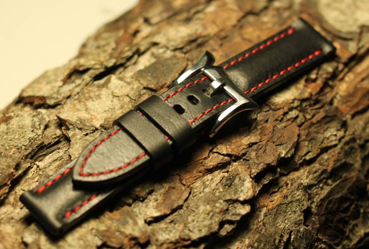

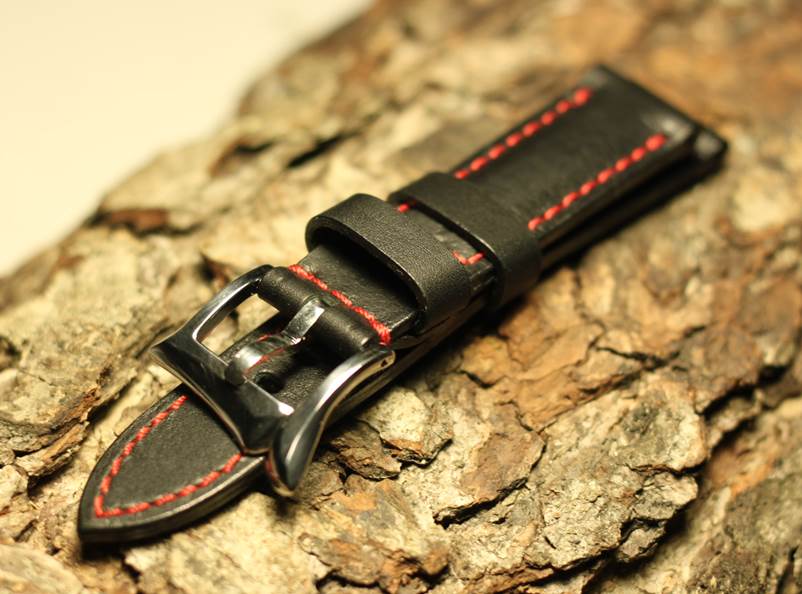

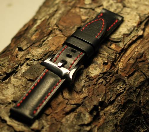

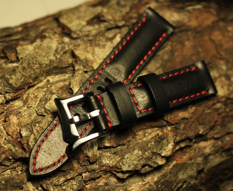

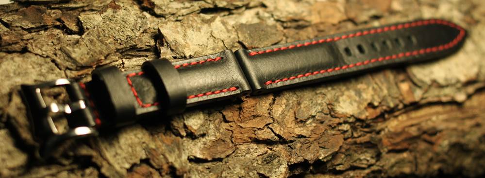

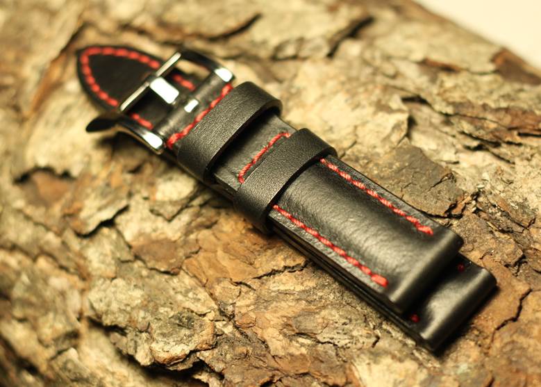

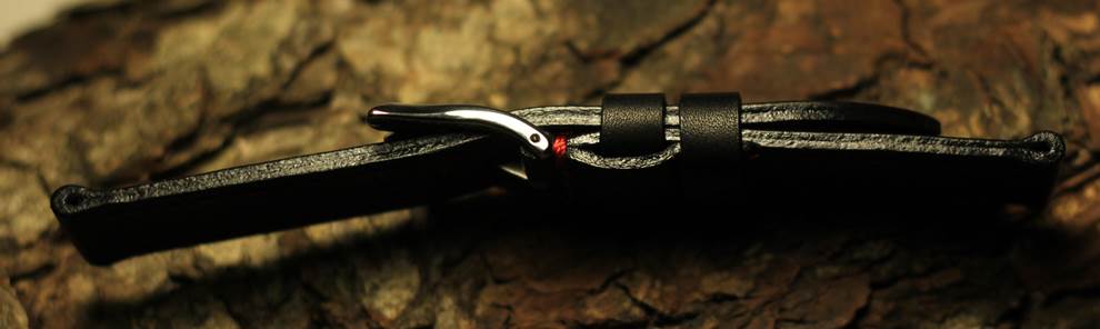

26/22mm

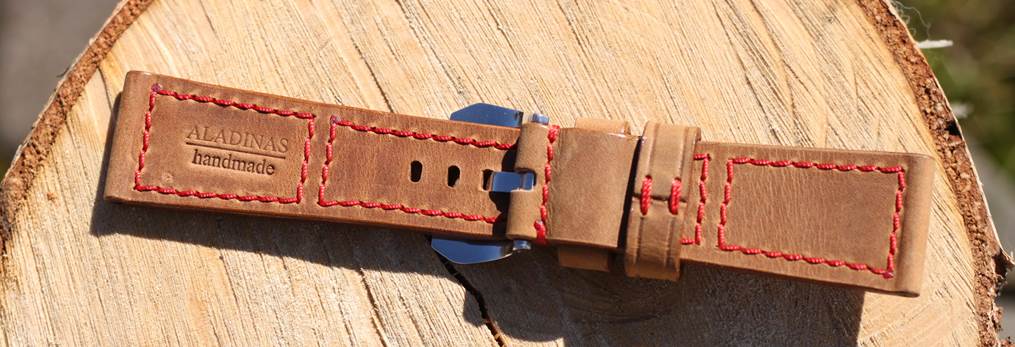

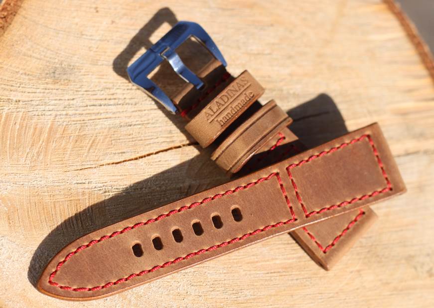

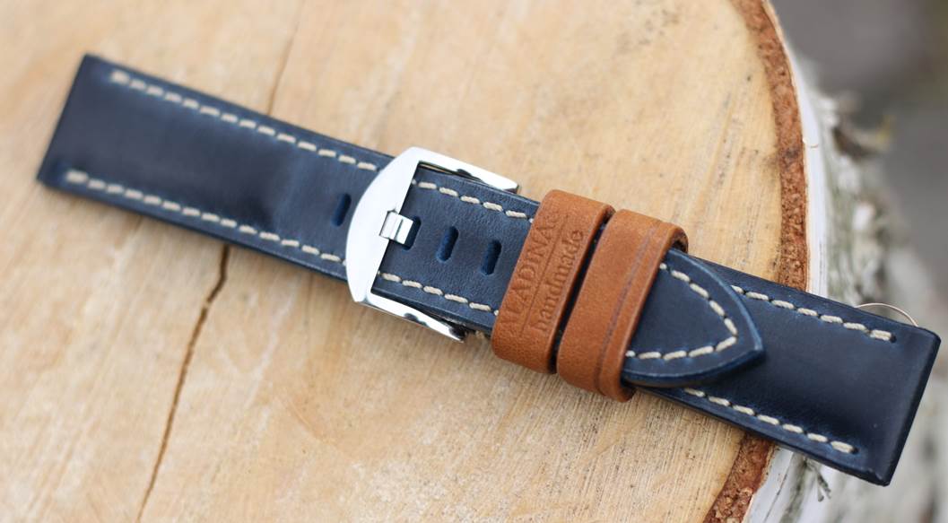

Aladinas
Red Edition
20/20mm 125/75mm
Aladinas
Red Edition
20/20mm 125/75mm

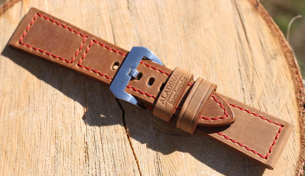

24/22mm
125/75mm
