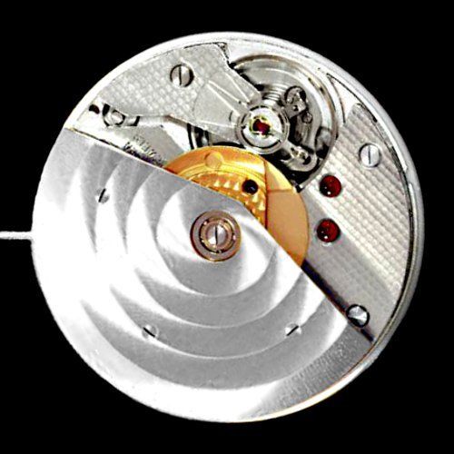

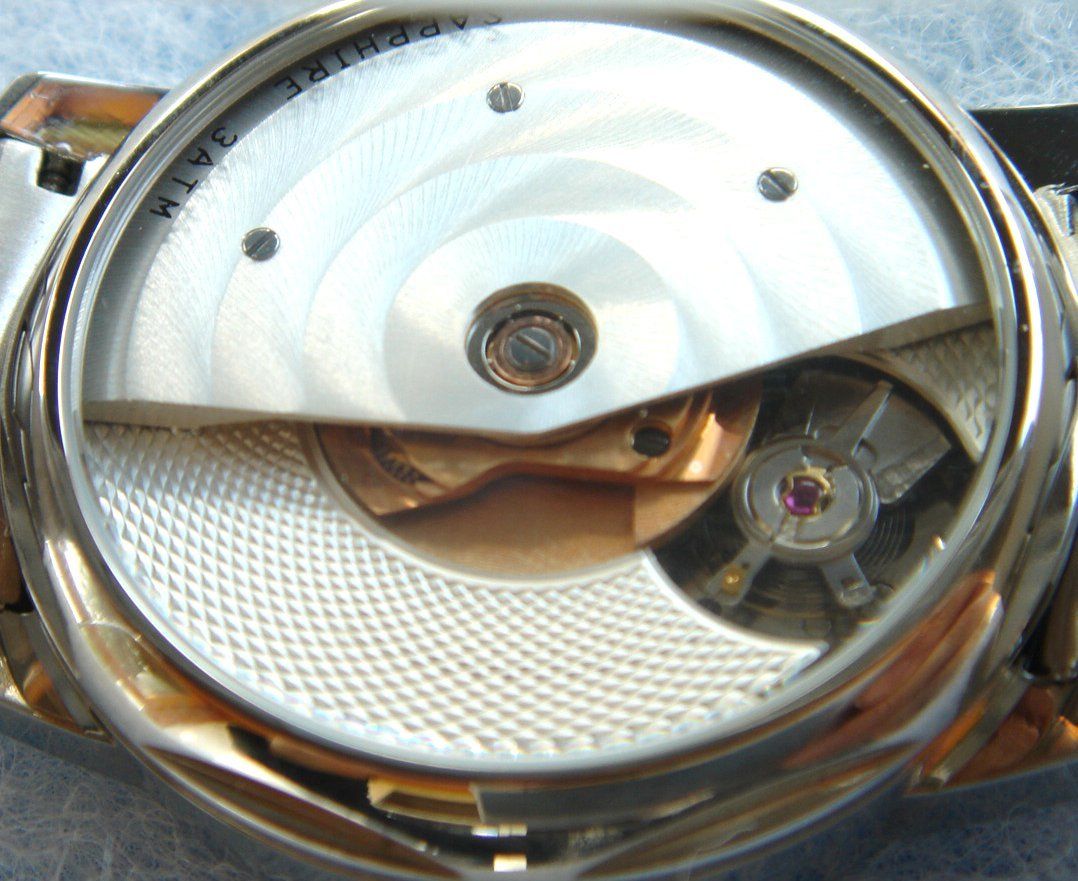

Необычные 6497
Сообщение от IVANH0E Посмотреть сообщение
Это U-BOAT?
чем дороже часы, тем "дороже" калибр.
Вот нашел в продаже интересную модификацию:
Brand: ERBE (Germany)
Manufacturer: RICHARD BETHGE GmbH, Germany
Model/Ref.: Nr. 962
Serial No.: Nr. 20
Case: Stainless Steel 316L - Side polished - Topside + Bezel brushed - ø 40 mm
Height / Thickness: 14 mm
Movement: ETA/Unitas 6497 with Automatic Module
Decoration: Guilloched 4/4 Main Plate / Full Main Plate - Concentric stripes on rotor
Indication: Hrs. Min. Sec.
Dial: Matt silver color Stainless Steel - Center part guilloched
Dial Signature: ERBE - Nr.20
Indexes: Applied Polished Stainless Steel Bar Indexes
Hands: Polished Steel - Feuille/Leaf Shape/Style - Superluminova
Crystal: Sapphire
Case Back: Screwed Sapphire Glass
Case Back Signature: SAPPHIRE - 3ATM
Water Resistant: 3 ATM acc. ISO 2281
Lug Width: 20 mm
Watch Band: Brushed Stainless Steel 316L Bracelet
Buckle: Deployant Buckle
