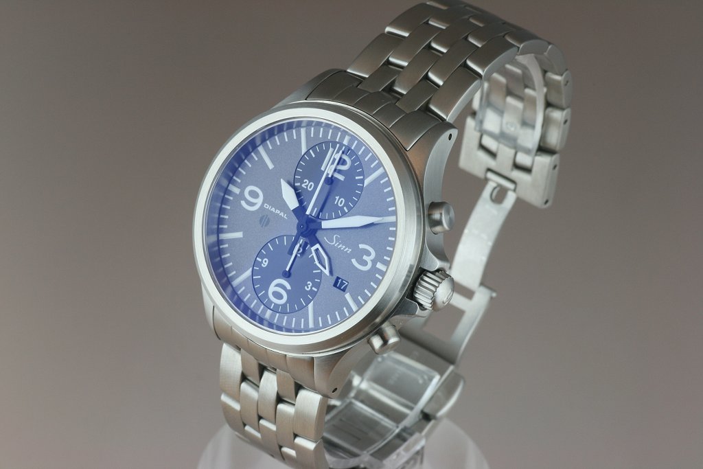

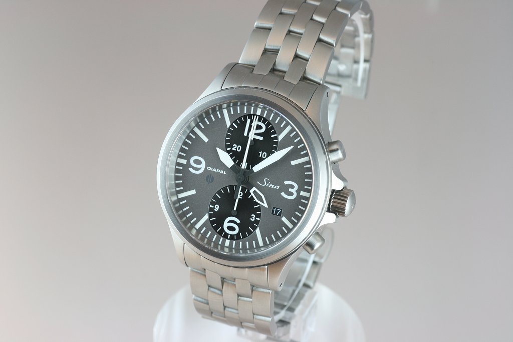

Diapal - рекламный ход или новое слово?
Уважаемые форумчане, хотелось бы услышать компетентное мнение по поводу внедрения немецкой маркой Sinn системы Diapal. Что это на ваш взгляд рекламная уловка или научно-техническое решение готовое поспорить с самим Коаксиалом)). Кстати немцы дают гарантию на часы оснащенные этой системой -5 лет. Это максимум, который я встречал у пройзводителей.
This is a brand new watch from Sinn, and is one of the most innovative and exciting new releases this year due to the special features of the movement. The Sinn 756 UTC DIAPAL is chronograph with a completely lubricant free escapement, which is a world first. Every wristwatch requires a service every few years as the escapement wheels and pallets need lubricating to avoid friction. Sinn used the technological innovations of the space program to develop a lubrication free escapement called DIAPAL, which is a reference to the friction reducing technique of replacing the ruby pallet stones with diamonds, hence the name DIAmond PALlets. The diamond pallets are then fitted to the traditional movements, in this case the Valjoux 7750, so you have the tried and tested Valjoux 7750, which is the world standard for automatic chronographs, which has been modified with space age technology to make it friction free. This is a technology which has been years in the making at the Sinn labs. In addition to the movement The cases are treated with Tegiment process. This is the process where the ice-hardened outer layer of special anti-corrosive stainless steel is hardened to 1,200 Vickers which is four times harder than nickeliferous high grade stainless steel used in other high quality stainless steel watches. This steel process is rarely found in watches, but is more often found in surgical instruments, and aerospace and aviation. The bracelet is treated in the same process to give it equal strength to the case. Has a sapphire crystal, screw down crown and is water resistant to 20 ATM. The dial is anthracite in colour with black sub dials and is an attractive and striking looking watch. The UTC hand is a dual time indicator and is independently set of the main hands and points to a second time zone. If you do not want a second time zone showing, the hand can be set to move in synchronization with the hour hand and it fits behind it perfectly so it will never be seen. Width is 40 mm excluding crown and 45 mm including crown Lug to lug is 47 mm, Thickness is 14 mm.

Что то новое безусловно в этом есть,но общей картины не поменяет,в одном месте можно убрать(понизить)трение в другом оно остается или становится больше.По гарантии-проверенный десятилетиями механизм почему бы и гарантию не дать на 5 лет,может в гарантийный срок нужно появляться на сервисе для регулировок,проверок и пр...

По-моему судить о таких инновациях можно только по истечении времени (3-5 лет,как минимум).....проверка временем и только....сейчас и одемар и улисс свои системы спуск выпустили...Какая система спуска лучше и точнее и менее глючная только время покажет.По живём ,по смотрим...
Анкерный спуск никогда не подведёт- эт точно

Репутация у Sinn весьма крепкая. И давать 5 лет гарантию на неопробированный девайс - может не каждый. AP или Omega не рискуют увелчивать гарантийный срок. Так в чем же фишка?
Очень бы хотелось услышать мнение профессионалов да и не только.
А вот собственно и возмутители моего спокойствия:

о сроках гарантии- к примеру, AUGUSTE REYMOND даёт гарантию и 5 и 10 и 15 и 25 лет (на некоторые модели), но на определённых условиях.Чисто рекламный ход,как-то ему ведь надо прорываться на рынке....Увеличение гарантии способ завоевать покупателя и привлечь внимание (ваше он уже привлёк...значит сработал ХОД).
Омеге и Одемару зачем такие заявления- они по другому себя рекламируют и другими методами завоевывают клиентов (Кино-Джеймс бонд, синди, пирс броснан,олимпиада, Регата итд) на войне всё оружие хорошо.

А почему бы и не дать 5-летнюю гарантию? Нормальный бренд, вполне серьезный, высокий балл по UE2007- 28 (для сравнения у тех же IWC 29), по качеству 5 из 6, ценник 6 из 6- более чем адекватный, кстати. Ну а другой момент- через пару-тройку лет часы становятся несколько "оббитыми", при постоянной носке- поэтому доказать отсутствие механических повреждений достаточно эээ...не просто- а, следовательно, и гарантии кирдык. Так что тут скорее да, ближе к рекламному ходу, чем к реалиям. Хотя, если так уж подумать- много у кого часы за 2 года погибли естесственной смертью, требующей гарантийных вмешательств? Я сомневаюсь.
