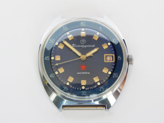

Visting from the WUS Forum looking for help. So far no one has been able to identify this watch. Hopefully you will be able to help.
What I've done so far;
Search every Ebay listing of Russian/Soviet watches
Search every image of similar Russian/Soviet watches on a Google search
Go through every Russian/Soviet watch catalog available online from 1976 to 2010
Ge through every collectors site I can find
Result;
Except for THIS watch (very first "Chistopol" shown)and THIS watch, I cannot find any other example of a two tab case of this, or similar, design that has any information.
I know the dial and hands are probably incorrect. Without any information on the watch, it will be impossible to correct it. Your help would be much appreciated.

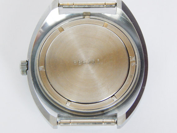

this is right assembled :
Название: NOS 7 - 12.jpg
ID:	990435   Нажмите на изображение для увеличения
Название: NOS 7 - 13.jpg
ID:	990436   Нажмите на изображение для увеличения
Название: NOS 7 - 14.jpg

Detailed pictures from my Google account
Disassembled
Movement front
Movement back
Dial
Case (note the two tab slots)
The two tab slots are not seen on any example of the watches from the catalogs.

on my watch only one slot
ID:	990502   Нажмите на изображение для увеличения
